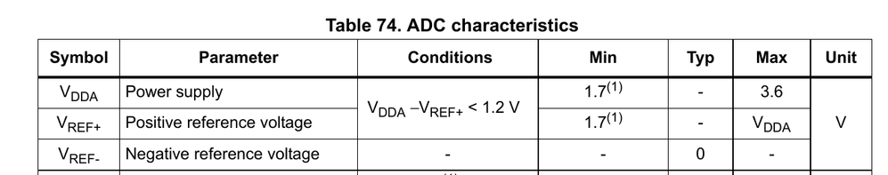

So the datasheet says "Min VREF+ Positive reference voltage - 1.8 V (1)(2)(3)", and note 3: VDDA -VREF+ < 1.2 V, so with VDDA at 2.925v, VREF of 1.755V would be permitted? Its a bit confusing to me at this point!
Given the ADC 12 bit resolution, the LSB is 439uV, which is too high for my application.
I can use hardware oversampling to increase the resolution, but can't find anything in the 32F407 datasheet about this feature or even an application note so not sure its supported?

I see it other-way, having VREF+ Positive reference voltage - 1.8 (1)(2)(3) MIN, and < 1.2 means you can't apply Vdda > 1.8 + 1.2 = 3 V if REF at minimum 1.8. For 3.3V Vdda , 3.3 - 1.2 = 2.1V REF possible as a minimum value.

Yes but note 3 is pretty clear no? My VDDA is​ 2.925 so applying note 3., VREF+ max at 1.75 is in limit, or did I miss something?

Vref can't be lower than 1.8V. So, if Vdda 2.925 , Ref can be set to 1.8V, for any value Vdda like, 2.5V, 2.0V, 1.8V etc, minimum Vref is still 1.8V.

So note 3 is totally wrong then? Surely if VDDA is lower VREF min drops too​, or is there a reason it must be no lower than 1.8v, any reference document beyond the datasheet?
The datasheet vref minimum spec of 1.8v perhaps isn't a fixed min voltage over gnd, but the lower limit below VDDA​, a difference voltage. Be good if an STM engineer might confirm.

I'd ignore note 2 as non sense . Obviously, if Vdda max 3.6V and Vref min 1.8V, than note 2 is always true. I checked with F446re DS, see:
Robmar
Senior III
That's the same formula as the f407vg, so putting in my figures 2.92 - 1.75 = 1.17, therefore < 1.2
​But the notes as you say make it unclear.
So you think vref must be > 1.8 over grnd, vss?​
From the same datasheet:
5.1 Parameter conditions
Unless otherwise specified, all voltages are referenced to VSS.
