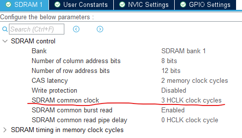

It looks like FMC has additional divisor for SDRAM.
Below is screenshot of my config for STM32F767 with LCD and display buffer in SDRAM.

Hi Paval, thanks for your answer,
Yes I am aware of this additionnal divisor but it would clock the FMC at 72MHz. So in that case, I would prefere to run the MCU at 200MHz to use HCLK/2 to clock the FMC at 100MHz :grinning_face_with_sweat:
Maybe it is possible to "overclock" the FMC :beaming_face_with_smiling_eyes:
