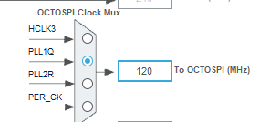

As for my clock setup:
The OCTspi is running at 120Mhz, but I have a clock prescaler of 2, giving me 60 MHz to start.
How do I debug or fix this? Could there be something wrong with my configuration that causes the memory access to fault?
Does my substitution of HAL_RCCEx_OCTOSPIDelayConfig with __HAL_RCC_OSPI_CONFIG make sense? What's the correct function to use in this context?
