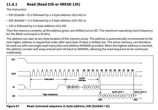

Hi everyone,
I'm using an STM32F767 with an S25FL256S NOR flash over QSPI in indirect mode (HAL driver).
I'm trying to write the string "HELLO" at address 0x000000, but after programming and reading, I always get: FF 45 4C 4C 4F → "ELLO".
The first byte is always 0xFF. All other bytes are written and read correctly.
What I’ve already done:
  • Verified Flash ID: 01 20 18 (correct)
  • Erased the sector before writing
  • Using 0x02 Page Program in 1-1-1 mode
  • Set SIOOMode = QSPI_SIOO_INST_ONLY_FIRST_CMD
  • Set FIFO threshold = 1
  • Using indirect mode (HAL_QSPI_Command() + HAL_QSPI_Transmit())
  • Test Code:
    char tx[] = "HELLO";
    QSPI_PageProgram(0x000000, (uint8_t*)tx, strlen(tx) + 1);
    QSPI_ReadData(0x000000, rx, strlen(tx) + 1);
    Why is the first byte not being written?

Accoding to the S25FL256S Datasheet the 0x13 read command needs a 32 Bit Address, but You are sending only 24 Bit.
  QSPI_ReadData
  Reads data starting at the given 24-bit address using the Read Data command (0x03).
  Datasheet reference: Section 11.4.1 (Normal Read).
HAL_StatusTypeDef QSPI_ReadData(uint32_t address, uint8_t *pData, uint32_t Size)
    sCommand.Instruction     = CMD_READ_DATA;
    sCommand.InstructionMode = QSPI_INSTRUCTION_1_LINE;
    sCommand.Address         = address;
    sCommand.AddressMode     = QSPI_ADDRESS_1_LINE;
    sCommand.AddressSize     = QSPI_ADDRESS_24_BITS;
    sCommand.DataMode        = QSPI_DATA_1_LINE;
    sCommand.DummyCycles     = 0;  // Normal read does not require dummy cycles
    sCommand.NbData          = Size;
    if(HAL_QSPI_Command(&hqspi, &sCommand, HAL_QSPI_TIMEOUT_DEFAULT_VALUE) != HAL_OK)
        return HAL_ERROR;
    return HAL_QSPI_Receive(&hqspi, pData, HAL_QSPI_TIMEOUT_DEFAULT_VALUE);

Yes, I tried using this command as well and observed the same issue. After checking, I noticed that the first byte is sent, but when I try to read the memory for the first time, it does not read the first byte. However, after the second read, I can read the full data bytes. So, I added a small delay, and it is now working properly.
Thank you for the help and suggestions.
