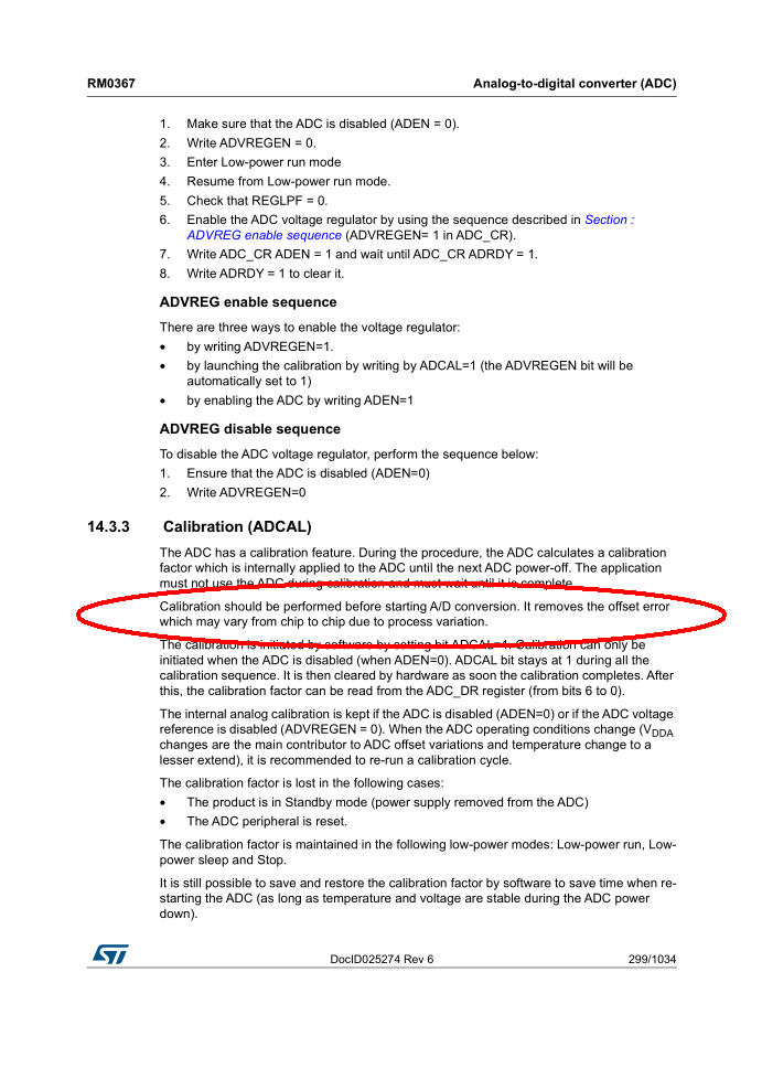

I have been testing the ADC on my STM32L0 with 12-bit resolution and for some reason, every measurement I take has a 0.048 V offset. I've tried a different supply voltage (from 1.8 V to 3.3 V), but the offset stays there.
This offset starts at the first count, when I apply 0 V to the ADC input and read 130 counts (with 1.8 V Vdda) it stays for the whole range.
My voltage source is very stable and I've verified my ADC input voltage and the STM32 supply voltage with 3 different accurate pieces of measuring equipment.
The board I'm using is a custom PCB, but I only placed the STM32 and some passive components to get it to function (coupling capacitors and reset pull-up).
I also tested multiple boards with different configurations and I always get this offset voltage. I outputed Vrefint and measured it, and I got 1.225 V (specified is 1.224 V) so the ADC reference seems fine too.
I was wondering if someone has a suggestion on the possible cause of this offset error? I've been looking for a solution but I'm having no luck so far, so I would really appreciate the input of more experienced developers.

AN2834 does not properly deal with the various ADC models in individual STM32 families, which vary quite a lot. The 'L0 ADC has a built-in calibration (i.e. hardware which subtracts the offset from every subsequent ADC conversion's result), but you have to start it manually before starting the ADC. This subchapter clearly describes the procedure:
0693W00000QMzyKQAT.pngThere may be some way to do this in Cube. I don't know, I don't use Cube.
PS. Are you sure all your ground pins including VSSA and on large packages VREF- are at the exact same potential?

I did a test where I outputted VrefInt and it was very stable at 1.225V (1.224V is the typical vrefint), so im fairly certaint that part is good. For the high imput impedance, I also tryed with 50 ohm but I got exactly the same offset. The gpio isn't set to a pull-up in stm32cubemx so I doubt it would be that. As for the calibration, I looked at this document : https://www.st.com/resource/en/application_note/cd00211314-how-to-get-the-best-adc-accuracy-in-stm32-microcontrollers-stmicroelectronics.pdf "AN2834 Application note How to get the best ADC accuracy in STM32 microcontrollers" and if I understand correctly, I would have to design my own calibration function? Basically, I could read gnd and set that to 0 point instead of 130 and the offset would be gone but I feel like this would be a bad way of solving the issue and it could backfire in the future.

Thank you for this information, I wasn't aware of the adc cal and It could be the cause of my offset, I will have to test it out. The chip im using doesn't have pins for VSSA or VREF- so im not sure how to probe them.

This means vdda and vssa pads are package bonded with vdd and vss. Once calibrated, play with sample and hold time to fine tune adc result value.
The calibration was what I was missing, I just added this line in initialize() and it made the offset disapear. I tested my adc with the same setup and I have a precision of around 3 count (1.2mV) which is really good. Thank you for the help again!
void initialize()
    HAL_ADCEx_Calibration_Start(&hadc, ADC_SINGLE_ENDED);
