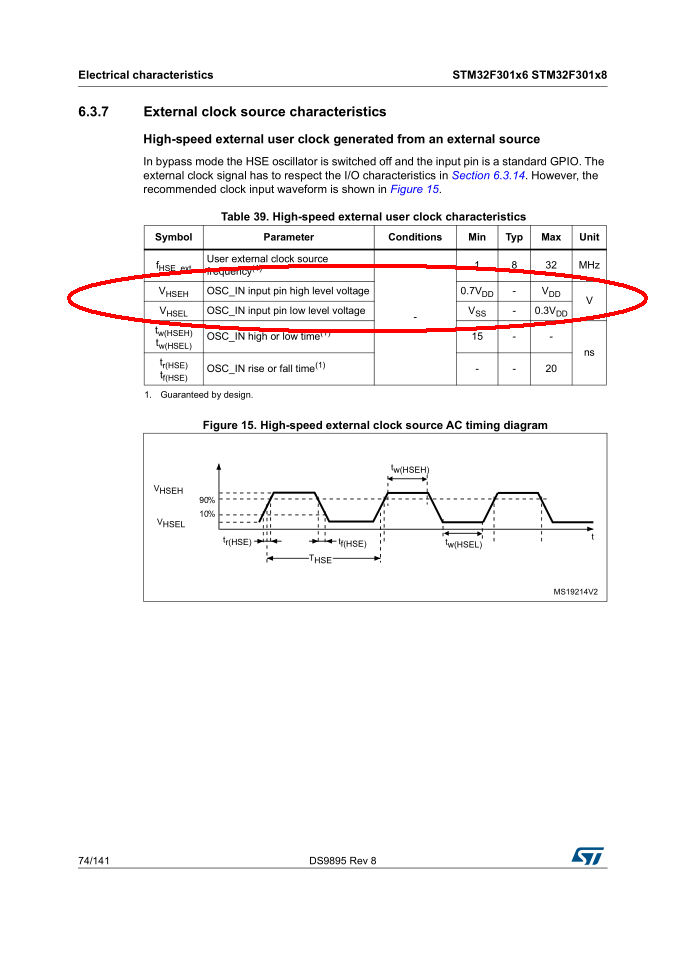

What are the voltage levels for RCC_OSC_IN
fal.sch
I want to use a HSE BYPASS Clock Source configuration with an stm32f301k6t.
Unfortunately I could not find any information in which voltage range my external oscillator should operate.
Sorry if the answer is trivial, I'm no expert in electrical engineering.
waclawek.jan
2 REPLIES 2
waclawek.jan
sorry for this rtfm question
