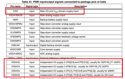

I guess VDD is independent from VDDIOx and supplies all GPIO that are not in the scope of VDDIOx, correct?
mƎALLEm
May 21, 2025
Yes VDD is independent from VDDIOx. Some IOs are power supplied from the VDD rails others from VDDIOx.
The VDD/VDDIOs distribution is described in the table 51 in the reference manual of the product::
