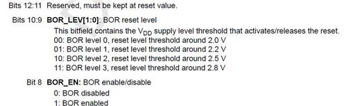

Hello @KSzcz.2 and welcome to the community;
First of all, thank you for posting.
You can find the correct BOR settings in the below:
This issue has already been reported internally to align reference manual, datasheet, STM32Cube_Fw_U0 and STM32CubeMX with this description.

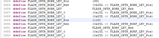

KSzcz.2
Thank you for your reply.
But what about bits 12:11? They are still assigned as reserved, but both in HAL and also in DS14463 - Rev 2 (18-Mar-2024) in 3.6.2 Power supply supervisor, can be read that "four (level as used) for falling VDD". A piece of stm32u083xx.h below:
KDJEM.1
Hello @KSzcz.2;
Bits 12:11 are reserved. As I mentioned in my last reply the datasheet, STM32Cube_Fw_U0 (stm32u083xx.h and stm32u0xx_hal_flash.h), and STM32CubeMx will be aligned with this description.
Thank you.
