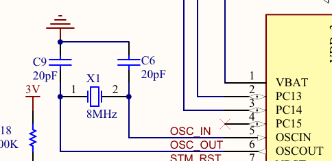

your osc circuit should look like this:
show your circuit, if you expect any useful help.

Here's the App Note https://www.st.com/resource/en/application_note/cd00221665-oscillator-design-guide-for-stm8afals-stm32-mcus-and-mpus-stmicroelectronics.pdf
Show your circuit as constructed.
The HAL Tick requires SysTick to be up and running.
The crystal has to start. The output can be probed if you enable it's output on PA8/MCO pin.
The MCU can crash if the PLL and FLASH wait states are wrong.
Make sure HSE_VALUE define in stm32f4xx_hal_conf.h reflects the speed of your external crystal.
