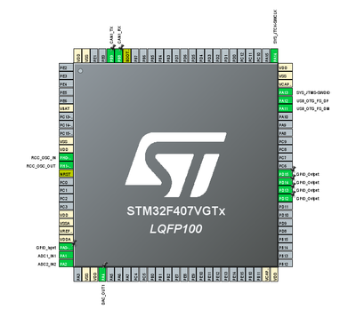

Hello everyone,
I’m currently experiencing difficulties with setting up CAN communication on my STM32F4 microcontroller. Despite having configured the CAN interface and connecting it to a CAN transceiver, I observe no activity on my designated can_tx and can_rx pins. I have a second node connected for communication testing.

  hcan1.Instance = CAN1;
  hcan1.Init.Prescaler = 6;
  hcan1.Init.Mode = CAN_MODE_NORMAL;
  hcan1.Init.SyncJumpWidth = CAN_SJW_1TQ;
  hcan1.Init.TimeSeg1 = CAN_BS1_11TQ;
  hcan1.Init.TimeSeg2 = CAN_BS2_2TQ;
  hcan1.Init.TimeTriggeredMode = DISABLE;
  hcan1.Init.AutoBusOff = DISABLE;
  hcan1.Init.AutoWakeUp = DISABLE;
  hcan1.Init.AutoRetransmission = ENABLE;
  hcan1.Init.ReceiveFifoLocked = DISABLE;
  hcan1.Init.TransmitFifoPriority = DISABLE;
  if (HAL_CAN_Init(&hcan1) != HAL_OK)
    ToggleErrorLED(8); // Toggle LED achtmal für Fehler in CAN1_Init

void Send_CAN_Message(void)
  myTxHeader.StdId = 0x321;
  myTxHeader.ExtId = 0x00;
  myTxHeader.RTR = CAN_RTR_DATA;
  myTxHeader.IDE = CAN_ID_STD;
  myTxHeader.DLC = 8;
  myTxHeader.TransmitGlobalTime = DISABLE;
value = HAL_CAN_AddTxMessage(&hcan1, &myTxHeader, TxData, &TxMailbox);
if (value != HAL_OK)
ToggleErrorLED(2); // Toggle LED zwölfmal für Fehler bei Send_CAN_Message

Sorry, I'm a bit of a forum newbie. Thanks for pointing out the clutter; I'll focus on the CAN functionality now.
I use STM32CubeMX to initialize the pins and most registers.
My board is the STM32F407G-DISC1, and though it might not be relevant, the transceiver I’m using is the LTC2875. To my knowledge, the pin configuration isn’t directly visible in main.c
I've already looked for examples but haven't found any specific to my board configuration yet. If you have any suggestions or know where I might find a suitable example, I’d appreciate it.
I'll take your suggestion to try a proper CAN example, perhaps starting with a loopback test to troubleshoot the initialization issue further.
Thanks again for your help!
I am no Cube user, I'm not sure where the GPIO initialisations are "hidden".
The CAN transceiver is basically only logic, so the type does not really matter.
But the board matters- the F4 Discovery is "old-school", being released quite a while before ST switched from the SPL ("Standard Peripheral Library") to Cube. Which means there are very few - if any - Cube examples available.

Check with F4 Discovery schematics which pins are free.
It seems this are only CAN_2 and PB12 / PB13 are available, the other pins are connected to onboard peripheral.

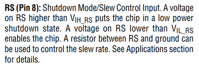

2 -  What about the voltage level on the LTC2875 RS pin?
Did you set that pin to the ground?
3 - Better to share your schematics especially the CAN part and also your project.
Hello mƎALLEm,
Thank you for your time. I am working in a lab and have access to another node which is conformingly working.
  • Regarding point 2: The RS pin is connected to ground, which should be correct.
  • Regarding point 3: The schematic has already been debugged and confirmed to work properly.
However, I am facing an issue where the board is not sending signals through the RX and TX pins. So my problem should be a software issue.
Im not quite sure what you are trying to tell me.
I could move my CAN1_TX and CAN1_RX pins to the pins colored black.
Thanks
Check the schematics of the F4 discovery.
Plus, there is a table in the user manual (of the F4 Disco), which explicitly lists GPIO pin usage and assignments.
If a GPIO pin is already connected to another peripheral, this will definitely interfere with your project - unless you modify the hardware. From the CAN Tx/Rx pins, only PB12 and PB13 are marked as "Free IO".
