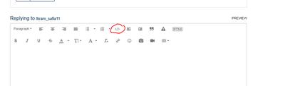

First, there is a "code formatting" tool available in the post editor. It's use is highly recommended for readability
