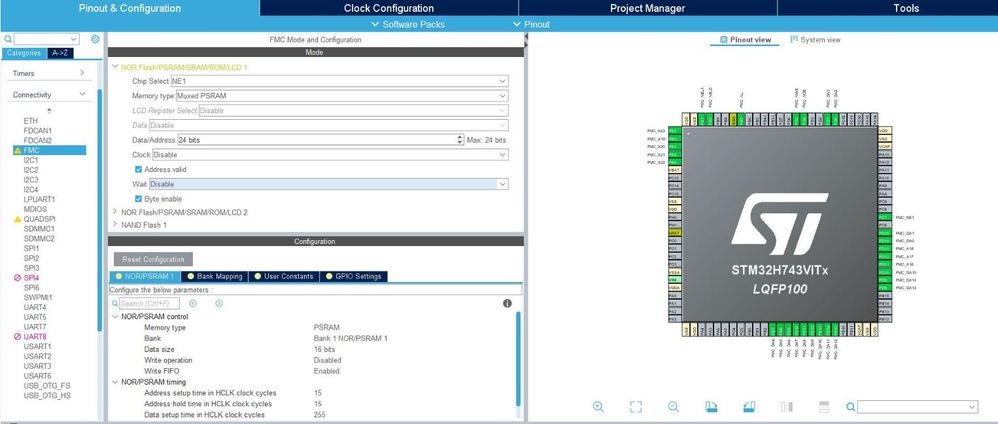

Hello, can we expand or use external RAM with stm32h743vit6? Could anyone guide me for the same?

Hello @prsh​ ,
You can use external RAM: FMC-SDRAM, as mentioned in the AN5188, in the Table 4. Peripherals required by memory type.
Check with CubeMx configuration:
You have these application notes that provide more details regarding external memory:
- AN4891 Application note STM32H72x, STM32H73x, and single-core STM32H74x/75x system architecture and performance
- AN5188 External memory code execution on STM32F7x0 Value line, STM32H750 Value line, STM32H7B0 Value line and STM32H730 Value line MCUs.

Sure, the FMC peripheral will interface with external memories such as SDRAM.
The STM32H743I-EVAL board as onboard SDRAM. You could use those schematics to see how it's wired, or use CubeMX.
