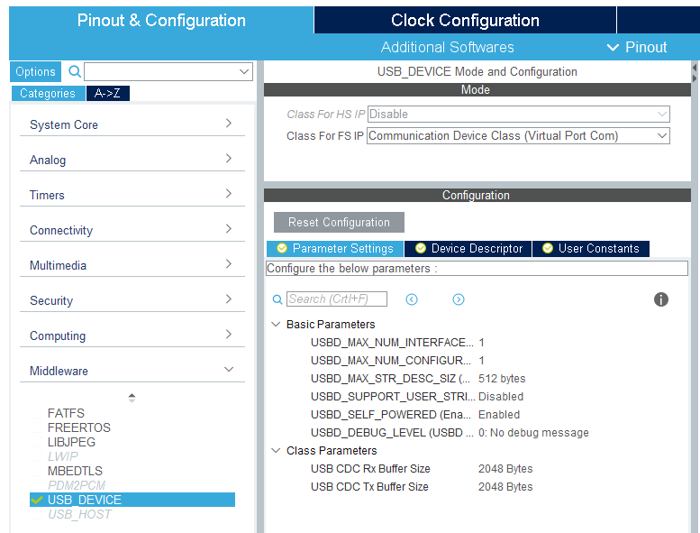

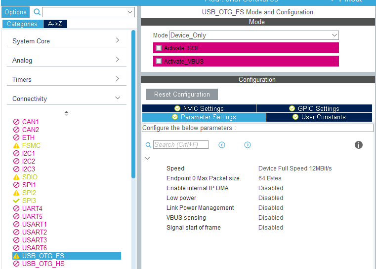

mmed
Hi all,
using windows 10,
I want to handle STM32F407 Disco via VCP. In the first case, i tried to configure UART but when i connect my USB TTL converter to my PC: it informs me that VCP error ''This device cannot start(code 10)''.
I thought that the probem is related to my USB converter
Then i tried to configure CDC USB:
USB_OTG_FS on mode Device only
activate USB_Device middelware in CDC mode
check the CubeMX file attached for more details
but the problem still exist!===> VCP error ''This device cannot start(code 10)''.

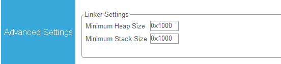

CanhNguyen
I have the same problem like you @med zarat ''This device cannot start(code 10)''.
Magically that when I change Heap Size from 0x200 to 0x1000 and Stack Size from 0x400 to 0x500, it will work.
I can see that both your Heap Size and Stack Size are 0x1000, but I do not why it is sill in that problem.
I think this is the problem related to memory.
Maybe you can change the buffer size of the USB?
This is my setting in STCube. Hope that it will be usefull.
CanhNguyen
