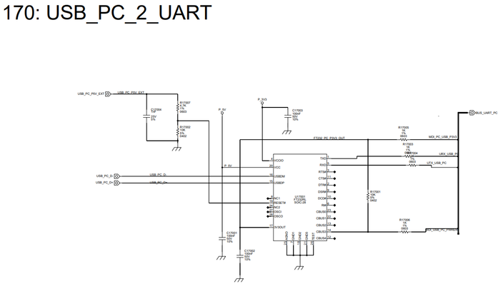

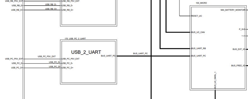

‎2024-05-08 8:57 AM
I have gathered information from the schematic of the GMSL UART connection to an MCU (Micro 100). This MCU is then linked to uart then PC via USB to receive commands through Tera Term or PuTTY. My question is about configuring the USB on the STM32. Should I set it up as a USB CDC device or host, or is there another configuration that I should consider? I apologize for any confusion in my explanation; I'm new to working with STM and this project marks my first venture into this field. Any guidance would be greatly appreciated.
