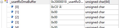

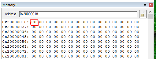

‎2020-08-07 12:30 AM
In debug I only observe the contents of the circular buffer used by the DMA (_rxDataCallback).
In the circular buffer only the first byte of the sequence (C0 10 00 05 43 C0) I send is stored.
I tried to view the memory contents by activating the "live update" or inserting a breakpoint, in the buffer I always see only the first byte.

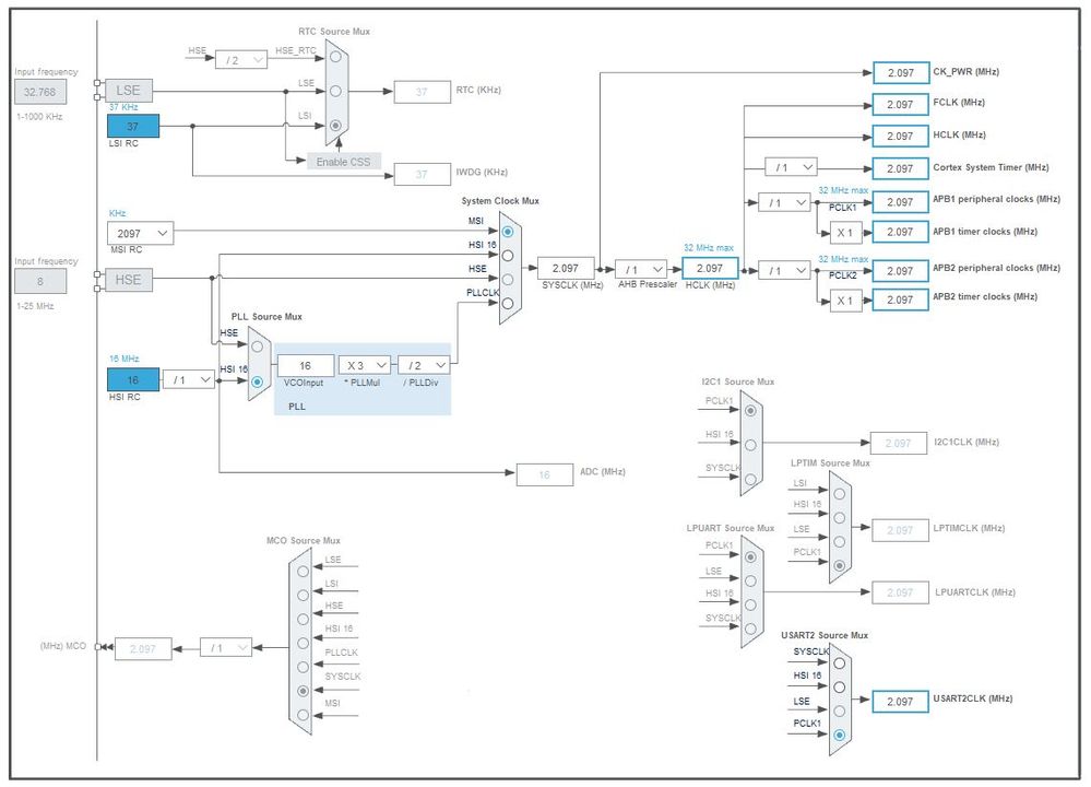

What's the baudrate and what's the system clock?

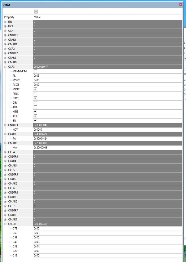

Sorry, maybe i didn't attach pictures correctly before.
The contents of the DMA registers remain the same after sending the packet.
I was already checking the ORE flag and in debugging I see that after sending the packet this flag is raised.
The USART2 baudrate is set to 115200 and the clock is set as in the image:
