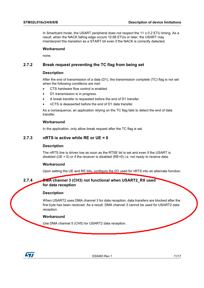

I have to transfer the bytes received from UART2 to the circular buffer via DMA. The microcontroller I am using is STM32L010F4  with LL instead of HAL.
When I send a sequence of bytes to UART2 I notice that only the first byte is loaded into the buffer and the UART IDLE interrupt is triggered.
Every time I send a sequence of bytes the IDLE interrupt is triggered but in the buffer I always see only the first byte.
Thanks!

yes, it works correctly because the result is 64
I am using the same code on a stm32l072cz and it works flawlessly (only change the channel used for DMA).
I tried to create a minimal program with only UART and DMA but also in this case the ORE flag is raised when I send a sequence with more than one byte.
In debug, however, I noticed a strange behavior of the circular buffer. When the code initiates the UART and DMA the circular buffer has 0x00 for each value.
If I send only one byte via serial line (0xAA for example), I notice that the first byte of the circular buffer (position 0) changes and correctly takes the value of the byte received (in the example it becomes 0xAA). The flag ORE is not raised! If I subsequently send a second byte (for example 0x12) the IDLE flag of the UART is correctly raised but in the circular buffer I see only the first byte sent (0xAA) and the second byte is not loaded into the buffer. Also in this case the ORE flag is not raised.
PS: when I send a byte the RDR register takes the correct value of the byte sent.

:face_screaming_in_fear: With channel_5 everything works correctly!
Thanks everyone for the help
