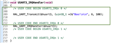

And on the above, is it a correct statement to say the following about this code:-
  • The code in the green box, is non-renentrant, that is to say, if an interrupt fires here from usart3, while its doing work but before it calls the read again on line 213, it is gaurenteed that another interrupt from the same source will not re-enter here?
  • Is it safe, required, advisable, or non-advisable to disable the USART3 interrupt in this block while processing the interrupt, and then re-enabled it before calling HAL_UART_IRQHandler()?
Hope this makes sense...
Gerry

DON'T DO THAT!!!!  Never call any blocking function from an interrupt handler.  It may/will delay the interrupt handler long enough to miss subsequent interrupts (i.e. miss incoming data).
TO answer your question - once the UART3 interrupt handler starts it will not get called again until the handler exits.  It may immediately start that same handler again if there is still a pending interrupt.  A different interrupt can interrupt this handler if it has a higher priority.
Do not "disable" the interrupt.  It is effectively disabled by the NVIC interrupt priority structure that only allow higher priority interrupts (lower priority values) to interrupt an active interrupt handler.
Correct, the interrupt cannot pre-empt itself and will not fire again until it completes.
Disabling it during the interrupt will have no effect. In that respect, doing so would be inadvisable/useless.
In this specific case, you are likely using the interrupt to receive characters. In order to avoid an overrun, you should make sure it returns before the next character comes in. It's impossible to satisfy this if you call HAL_UART_Transmit, so instead save the data to a buffer, or set a flag, or do some other action and act upon that in the main thread.
I think this answers your main post as well. Throwing characters into a buffer in the IRQ and then handling that in the main thread is a viable and advisable approach. You will need to do so in a thread-safe manner, but this is quite doable.
