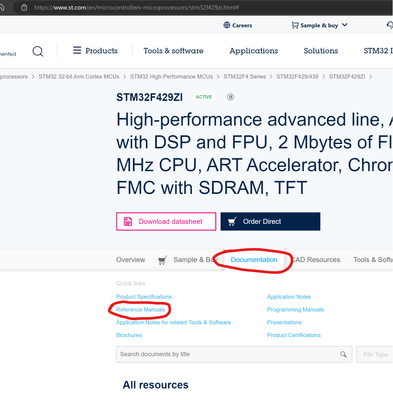

> Can I ask how you located that document, so I can try and find the same one for the chip I am using please?
Personally, I just google "stm32f429 reference manual" and it typically comes up.
It should also be listed on the part page. Navigate to Documentation and then to Reference Manuals
https://www.st.com/en/microcontrollers-microprocessors/stm32f429zi.html#

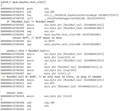

I understand the microcontroller is basically single threaded, and an interrupt is simply a suspension of what is currently processing and a crude context switch (i.e call an ISR function), I get that, but the point I am making above is, your C code generally translates to a larger number of machine code instructions.  Forgive the fact this example is in x86 code (same thing applies), that is a simple function to get the next slot in a simple 16-slot ring buffer. The vast majority of these instructions are NOT atomic, and certainly the registers can easily be re-used.  So if you take that example code, it could very easily be that in your main loop, you are executing this code, and the line where you are setting eax register to the value contained in  the memory variable MainBuf_tail. An intterupt arrives so your program stops immediately after that instruction line, and the CPU calls your ISR.  In your ISR code you do some other work that involves using the eax register, so its value is changed.  Upon the ISR completion, your codo resumes at the next instruction in the code below where ecx is being set. The line after that compares ecx with eax, but eax now has a different value in it then it did before the ISR was executed.  At that point, at best this code will give the wrong result, at worst it could crash.
So it does depend on the CPU, but as a general rule, updating a pointer (which is in a ram memory location) will almost always have temporary variables, if of those are just registers like shown in this example.
All CPU's that are thread capable, or multi-code, have some very specific and well documented instructions that are gaurunteed to be atomic, basically uninterruptible, these are typically register-to-register value exchange or register -memory-to-register operations. On CPU architectures that are not inherently design with multi-core in mind, will have some well defined way of safely executing ISR's, generally this means the ISR should save all and any registers its going to mess with, typically on the stack, and then when complete restores the register values before returning from the ISR.

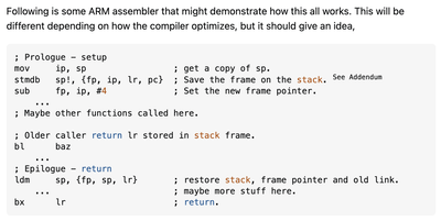

On further update, reading another article, its suggesting the ARM cortex does not its self save anything, appart from the stack and frame and instruction pointer registers, it appears to be left upto the C compiler to implement the prolog/epilog to save/restore registers.  The ABI used by the compiler seems to dictate which registers are/are not saved/restored.  So the answer would appear to be - consult the "C" compiler...
Fair enough...
It would seem reasonable to assume that the ARM core does not have some magical "save and restore all registers automatically when entering an ISR and restore them all back on exit"
The Cortex-M architecture with its NVIC interrupt controller is relatively new. They took lessons from most things you've mentioned and the result is very efficient and elegant. Yes, it saves and restores the important  registers automatically. In short, interrupt handling works mostly intuitively. It does what you want for small embedded systems, and in the way you want it. Yes there is an ABI (few variants for different FPUs), provided by ARM.
