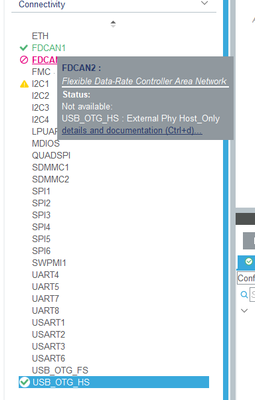

I want to use the ULPI interface & both the CAN interface for my project
But I see
For USB:
Pin No: 194     pin name: PB5     Module function :  USB_OTG_HS_ULPI_D7,   ONLY ONE PIN no other pins are there
For CAN
Pin No: 194,195    pin name: PB5,PB6     Module function :  CAN2_RX,CAN2_TX
Pin No: 104,105    pin name: PB12,PB13     Module function :  CAN2_RX,CAN2_TX
How to proceed with it, since we have clash with Pin No 194?
Doing the exercise on STM32CubeMX, it seems you cannot use FDCAN2 with USB_HS with external PHY as they share some IOs:
So you can't use both USB_HS and FDCAN2 at the same time. Unfortunately, no alternative for FDCAN2

To be exact which part number? (STM32H743BIT6 ? as per your previous thread). That indicates also the package.
As suggested in the datasheet STM32H743BIT6 we are interfacing it with USB3320 using ULPI interface, apart from this we have using CANFD 2 interfaces , there we are seeing that pins are overlapping, where in we cannot support these 3 (CANFD1, CANFD2, ULPI), Am I wrong somewhere?
yes this was the confirmation required, No alternatives ?

Already answered that question in my previous comment: "Unfortunately, no alternative for FDCAN2"
