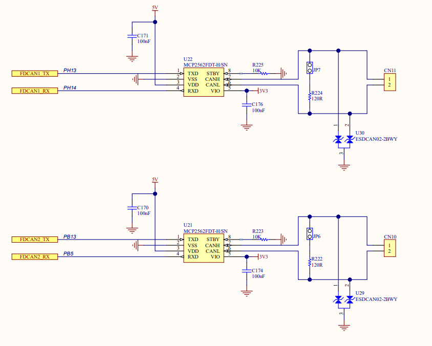

Does the CANFD interface on STM32H745I-DISCO Discovery Kit directly connected to the CAN bus or need a transceiver? If need transceiver, which transceiver could be advised?

In the STM32 and other microcontrollers, only the CAN or FD-CAN MAC (media access controller) is included, the associated PHY (transceiver) must be connected externally.
Since FD-CAN (aka CAN FD) is standardised, you can connect any PHY.

Hi Peter,
Thank you and for STM32H745I-DISCO Discovery Kit this kit, does it integrated PHY (transceiver)?

Yes, as you can see in the schematics of the MB1381, this DISCOVERY also includes the FDCAN transceivers (PHY), one for each of the two ports.

You don't need to add transceivers as STM32H745I-DISCO Discovery board features already two transceivers MCP2562FD which can support up to 8 Mbps Operation. Also you don't need to add termination resistors of 120ohm:
