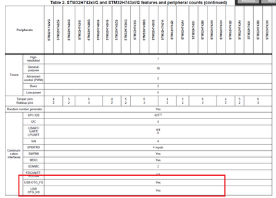

Will STM32H743BIT6 support only OTG_HS mode?
Will it support normal USB operations by disabling OTG option? If yes which pin will control that functionality?

May 20, 2025 11:08 AM UTC
Hello @Meghna and welcome to the ST community,
The question is not clear.
STM32H743 supports USB High speed and Full speed:
What do you mean by normal USB operations? USB 2.0 or what?
MeghnaAuthor
May 20, 2025 11:10 AM UTC
Considering USB 2.0 HS & FS operations are different from USB 2.0 HS & FS OTG operations, Correct me if I am wrong

This this what the reference manual is telling / chapter 57 USB on-the-go high-speed (OTG_HS):
MeghnaAuthor
May 20, 2025 11:12 AM UTC
It shows that STM32H743BIT6 supports only FS operations, why?
mƎALLEm
May 20, 2025 11:22 AM UTC
You need to provide the document from which you captured that screenshot.
