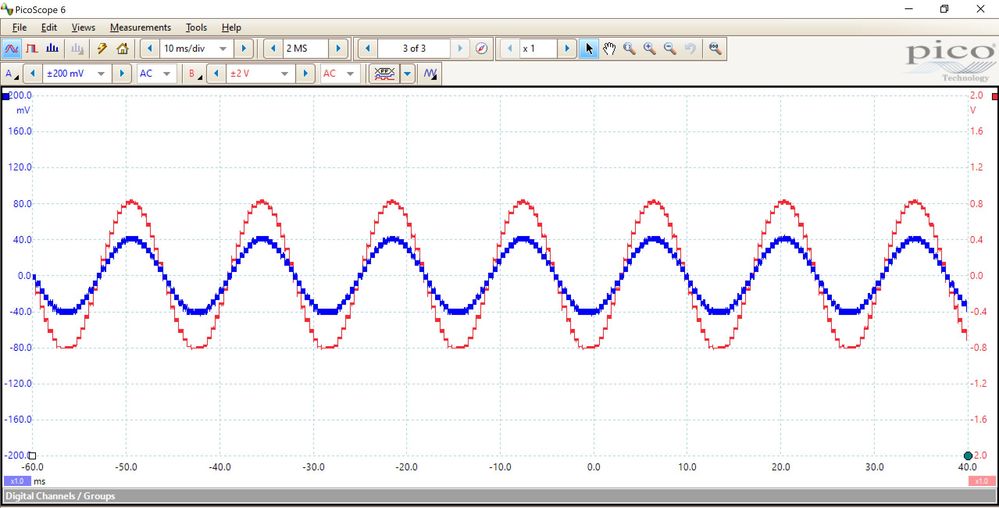

I have another question:
0693W00000FARNMQA5.jpgThe above pic shows the signals captured from DAC and OPAMP output pins: blue is DAC; red OPAMP.
What puzzles me is their amplitudes: DAC output is from -40mv to 40mv; while OPAMP output is -0.8v to 0.8v. The gain is 20 times, but for OPAMP PGA setting is
  hopamp3.Init.PgaGain = OPAMP_PGA_GAIN_2_OR_MINUS_1;
@Igor Cesko​ sorry, my fault. The two probes themselves have 2 different gains: x1 & x10, so now everything makes sense.
Thx.
Check your measurments. Looks like you have wrong osciloscope probe configuration in you SW (10x vs 1x).
