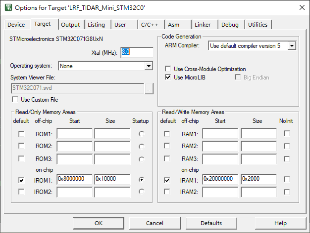

I bought few STM32C071G8U6N from Mouser few month ago.
As I know, the SRAM size in spec is 24K, but I will get error message as below when ZI-data over 8KB
"Error: L6406E: No space in execution regions with .ANY selector matching xxx.o(.bss)."
Program Size: Code=33736 RO-data=360 RW-data=132 ZI-data=6724
And the data in iirDataQueue will change into 8192 or around 65535 unexpected.. Following is my code(work fine on other platform), (iirData is no error).
memmove((uint16_t*)&dspMem.iirDataQueue[0], uint16_t*)&dspMem.iirDataQueue[1],
            (ADC_DATA_QUEUE_LEN - 1) * sizeof(dspMem.iirDataQueue[0]));
dspMem.iirDataQueue[ADC_DATA_QUEUE_LEN - 1] = dspMem.iirData;
We have also been using other series of products for a long time, such as STM32L4, but none of them is as frustrating as STM32C071. Could you please provide me with some direction to debug? Thanks.

Then simply change 0x2000 (8k) to 0x6000 (24k)

Seems more as Keil question not STM. Show your sct file or memory config window in project... Spec is irelevant
+1 Check the CPU Target in the project configuration pane (Device & Target)
You can also say the SRAM is bigger, until you get closure with the Linker, and then look at the .MAP to understand who/where/what is consuming it.

Thank you, this is my screenshot. The config is generated by CubeMx.
Not sure where the wrong setting is coming from. Might check your local Keil pack

STM32C0 is a new family, maybe Keil does not have specs for some C0 chips yet. Just correct the values manually. Install updates if available.

Finally,
I found my hierarchical structure definition in .h file can't be handled correctly.
After I flatten the structure definition, no memory error and crash anymore.
