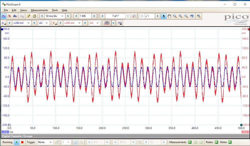

0693W00000DntA6QAJ.jpgThis is the case of OPAMP_PGA_GAIN_2_OR_MINUS_1: blue line is output by DAC and red is by OPAMP.
My 1st question: why the amplified signal is distorted. Isn't it supposed to be another sine wave?

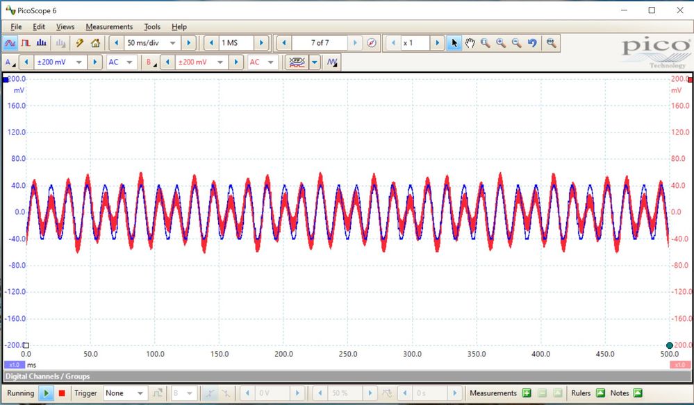

0693W00000DntCRQAZ.jpgThis is the case of OPAMP_PGA_GAIN_4_OR_MINUS_3.
My 2nd question: the amplitudes of the amplified signal seem not matching the gain.
Once the gain >= 8, the amplified signal becomes almost straight line. I also wonder why.

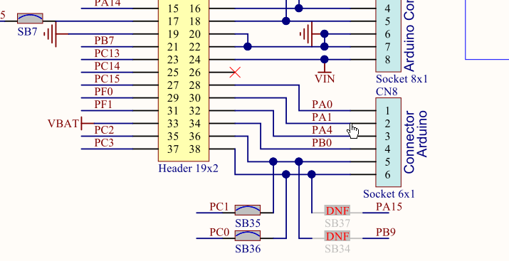

0693W00000FAJrZQAX.pngHi @HDaji.1 (Community Member)​ ,
Did you connect externally PA4 (DAC1_OUT1) to PA1 (OPAMP3_VINP)?
Those 2 pins must be connected together to sent signal from DAC to OPAMP. Those 2 pins are beside on Nucleo - so probably you didn't connect them together and there is only crosstalk from PA4 to PA1.

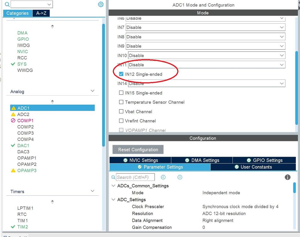

First thing to do in your case is to change OPAMP mode as "PGA Internally Connected" from STM32CubeMX configuration wizard.
Referring to the table "Operational amplifier possible connection" of the reference manual RM0440, you can see that OPMAP3_VOUT can be connected to ADC1_IN12 or ADC2_IN18 (on STM32G431RB).
If you hover over the cursor on ADC1 or ADC2, you will have a pop-up guiding you each time on the configuration to setup:
0693W00000FA8FdQAL.pngOnce the configuration is done, you can generate your project and the new setup will be added to initial project.

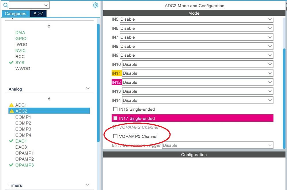

0693W00000FAHrlQAH.jpg@Amel NASRI​
I checked IN12 Single-ended. Anything else?
And in ADC2 menu, I don't see IN18, instead it is sth like this:
Why is it different from ADC1?

@Igor Cesko​ Once I connect PA4 to PA1, I see amplified signal from PB1 (OPAMP3_OUT). Thx for the tip.
In the readme file, it says "Connect a wire between DAC output (PA4 - pin 32 on connector CN7) to OPAMP non inverting input (PB0 - pin 34 on connector CN7)". I guess it is wrong, isn't it?
