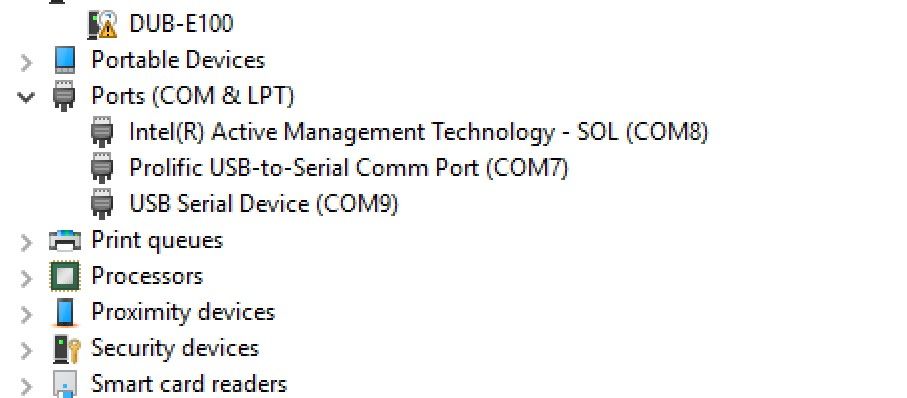

Now i got my composite device working any idea why i can't connect to USB Serial Device COM Port?
