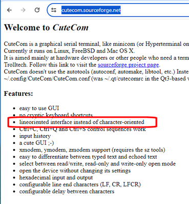

This: https://cutecom.sourceforge.net/ ?
I note:
So are you sure that your code is sending in a proper format that CuteCom will recognise as a "line" ?
All I am doing is sending 2 byte data over UART TX and trying to sniff the data on TX line to make sure it matches what we are sending from the main function.
Note - We are running on ubuntu so cutecom is the tool I could find.   Cutecom is able to see my device on tty/USB0 and attach.
Do you have any other tool I can use in similar fashion to see what exact data being sent out on UART TX line ?
As I said, I don't know this "CuteCom" and, therefore, don't know exactly what it means by "line-based" - but I suspect it's not the right tool for doing that.
Especially as it also says it's not "character-oriented".
Again, have you tried with PuTTY and/or an oscilloscope?
