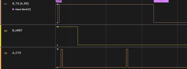

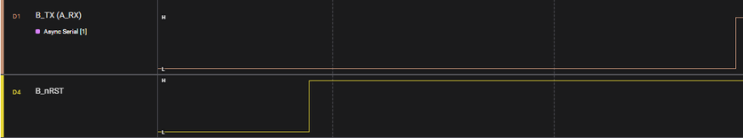

Assume UART of A is already configured, B is kept in reset (by A, reset line B_nRST is active low). While B is in reset, its TX line is not at the usual UART idle high level but at low level. A controls B out of reset. It takes some time until B comes out of reset and finally pulls its TX line to UART idle high level.
Afterwards, B transmits data and A controls its CTS line as expected. The bigger picture:

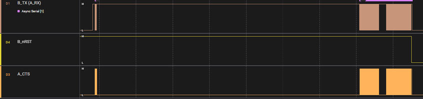

Let's zoom to the very end. After exchanging some data, A will put B back to reset (zoomed in at the end of the previous screenshot):
It can be seen that after having pulled the reset line low, that B's TX line falls from UART idle high level to low.
Having B's UART TX line low leads to framing errors in A's UART peripheral in the RX path. (That spike in the CTS signal may be an artifact that originates from A UART de-initialization.)

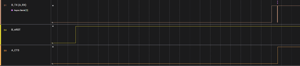

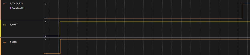

B is kept in reset for a while. Before starting another phase of UART communication, B is pulled out of reset again and the procedure is expected to repeat, but I only see two "unexpected" cases:
Case 1) A's CTS line is permanently pulled high after A has received the first byte from B so that B will stop sending any furhter data:
Case 2) A's CTS line is permanently pulled high from the very beginning:
