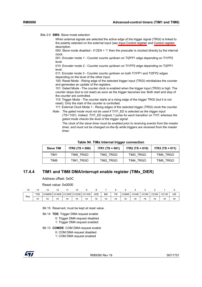

TIMx_SMCR description refers to nonexistent registers
waclawek.jan
These are obviously leftovers from text which was in description of whatever mcu famiy the original source of this timer was (ST9 family?).
This of course goes across all timer chapters within this RM, and across several RMs.

Seems that it is present in all STM32 reference manuals starting from F1 up to U5 series.

I confirm that the TIMx_SMCR description refers to nonexistent registers.
I reported this issue internally.
