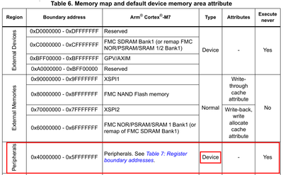

Most code examples for STM32H7RSx and STM32H7x (e.g., https://github.com/STMicroelectronics/STM32CubeH7RS/blob/4891e67739a01faea3c35d7a9bdccea6970266fd/Projects/STM32H7S78-DK/Examples/GPIO/GPIO_IOToggle/Appli/Src/main.c#L171) don't define memory properties for the peripherals region (0x4000_0000 .. 0x5FFF_FFFF for STM32H7RSx) by means of an explicit MPU config, but they do define this by means of the implicit MPU region -1 by means of calling HAL_MPU_Enable(MPU_PRIVILEGED_DEFAULT). This means privileged code will access the peripherals using the default memory properties which can be found in the MCU's reference manual. For the peripherals, this is with the Device memory attribute:

I happened to run into this using an MPU config that defines an explicit MPU region including the peripherals region with the Device memory attribute set: the target froze on a "LDREX [0x4000_4C00, #0]" instruction (UART4 CR1 on STM32H7S3). Normal debugger access was not possible anymore (I had to use HW instruction tracing to figure out where it hung). The corresponding code for that instruction was in "stm32h7rsxx_hal_uart.c" in UART_TxISR_8BIT():
