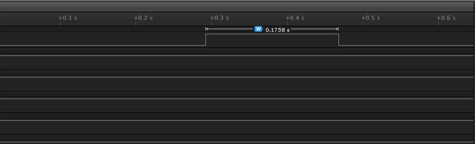

waclawek.jan
Toggle a GPIO output pin when entering the TIM interrupt and observe on oscilloscope. You'll probably be surprised.
> TIM3->EGR = 1<<1;
This forces an interrupt.
And you don't clear the interrupt source in the ISR.
Nchun.1
Senior
Sorry ,After Toggling pin i am not finding any difference after/begore disabling TIM3->EGR for below.
The timeStamp1 value is getting updated after the Disabling Event Generation Register
> TIM3->EGR = 1<<1;
