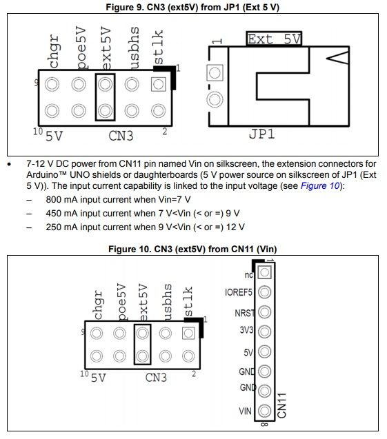

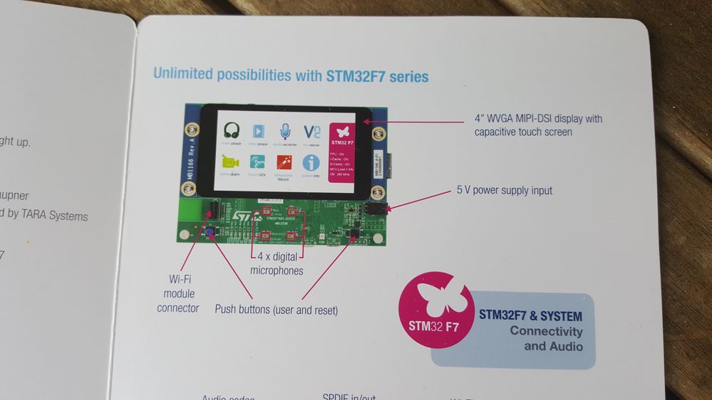

Hello! I've bought that kit and I would like to know where I can find the kind of wire which could enable me to power it without using either USB ports or Ethernet one.
Below a picture which shows you this input with the mention "5 V power supply input". 0693W000008zsFsQAI.jpgI truly thank you in advance for your help.

First use USB connected to the Stlink as power input. Care for the correct jumper setting.
There isn't a magic cable/wire
You could perhaps review the schematic to understand all the possible options and injection points.
https://www.st.com/resource/en/user_manual/dm00276557-discovery-kit-with-stm32f769ni-mcu-stmicroelectronics.pdf
