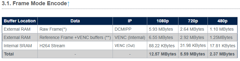

exarian
Thank you @DanielS for your feedback.
Adding the 1080p support would be great, thank you.
Specifically how to manage the memory around buffering the camera frames in External memory, or using the "Slices".
I look forward to seeing this, and I know it will be helpful.
