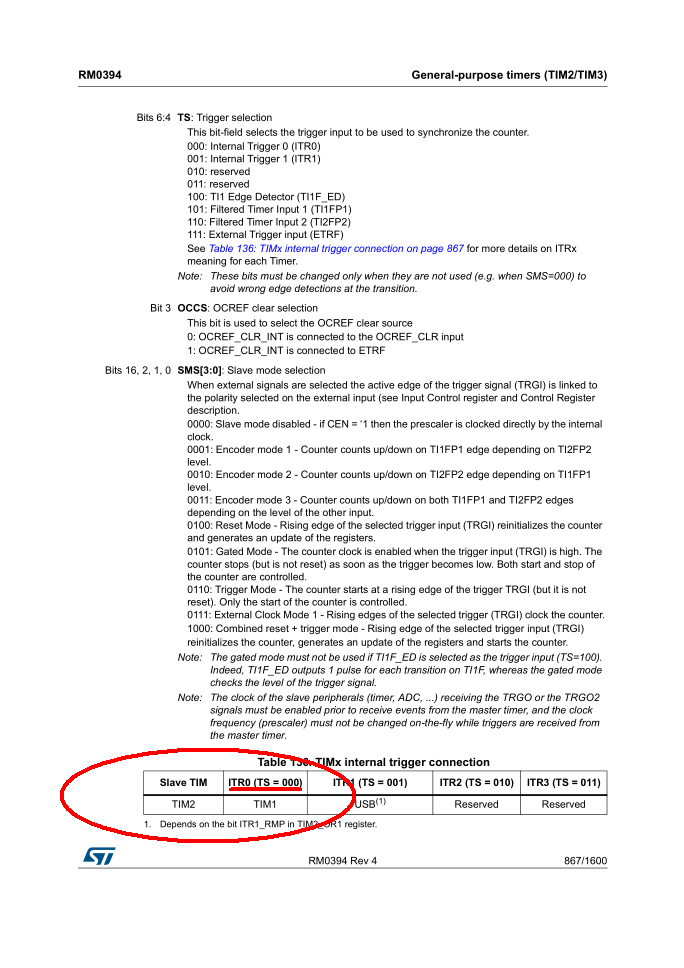

In my project I need to generate 1s on, 1s off PWM signal in hardware.
First I checked if my PWM works with simple project, and it does.
But following AN4776 for N-pulse waveform generation application example - part 1.

So my Master Timer is timer 1 to generate events to generate n-th signals from TIM2. But the problem is, i just get nothing. PA15 is also enabled with based on working example with just TIM2 pwm generation:

‎2021-04-18 2:32 AM
> TIM2->SMCR |= LL_TIM_TS_ITR1;
This probably is the cause of the problem.

‎2021-04-18 2:53 AM
Hello waclawek.jan, and thank you for these points, I was reading reference manual, but did not get to this part yet.
in that case I just have to use second timer to generate update events, and use IRQ event to enable/disable or load 0 or period/2 into CCR1 register by software. And because it is just 1Hz or something similar, it would not cause any large impact on CPU performance.
‎2021-04-18 3:12 AM
I didn't say that.
Just change TIM2_SMCR.TS to ITR0.
