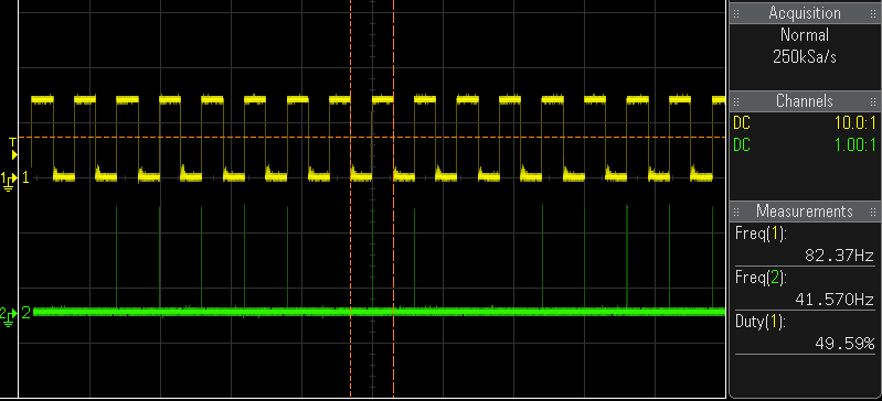

Interrupt is simple as possible: im not counting value for now (math from SPL examle I used to were giving me inconsistent results), now I'm just reading it. When I measure the difference between two interrupts I'm getting consecutive results like this: 47 21 95 90 156 65405 95 65363 159 144 22 48 etc.
So, I fire output PIN on every interrupt for debug purpose with oscilloscope.
void TIM2_IRQHandler()
	GPIO_SetBits(GPIOB, PIN_LED_OUT);
	if(TIM_GetITStatus(TIM2, TIM_FLAG_CC2) != RESET)
		TIM_ClearFlag(TIM2, TIM_FLAG_CC2);
		value = TIM_GetCapture2(TIM2);
	GPIO_ResetBits(GPIOB, PIN_LED_OUT);
But the picture I get looks like this:0693W000008yz12QAA.pngLooks like at random interruptions are not fired.
I've tried different channels, different filter settings, different timer scale settings, even different voltage levels. I can't change MCU clock speed.
I suspect that explanation to that is simple, i'm just missing or don't understand something.
Hope for your help stm gurus.

Prescale and Period values are N-1, with such a small range I'd use a prescale of zero. Currently count is modulo 201
F​or time measurement, consider another TIM in maximal mode, ie full count, and either use input capture or pwm input there.
C​lock divider is for input filtering.

Are you sure it's not your oscilloscope which simply misses some of the pulses, as it's running at 250ksamples/s?
April 8, 2021
Thank you. You are both right.
First of all, looks like modulo 200 really is one of the problem.
So, I moved Timer Input to TIM1 with Period 0xFFFF and Prescale 1000. Capture results in ticks is pretty consistent.
Also, now I see, that interrupts are not skipped, that was oscilloscope skipping impulse XD.

And TIM1Freq gives me the exact value same as on oscilloscope. Nice.
Sad that i cant use original timer, because board is already manufactured. So I think I will measure frequency with EXTI interrupt. Not so elegant as this solution.
