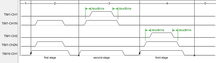

above wavform is I want to generate .
divided into three stages , every stage config different period and pulse
for timer feature " Complementary output with dead-time insertion" use generate deadtime .
waclawek.jan
This can be achieved by dynamically changing content of TIMx_CCER between stages.
For disabling any of the complementary channels, e.g. as for CH1 in phase 2 (first stage), you simply clear the respective TIMx_CCER.CCxE/CCxNE; enable that channel by setting the respective CCxE/CCxNE bit. The disabled channel can be left floating (possibly pulled to the required state by setting a pulldown/pullup in the respective GPIOx_PUPDR), or set to the inactive level, depending on TIMx_BDTR.OSSI. Note, that when both channels are disabled, OSSI won't apply, they both are floating.
You may want to switch on preloading of those bits by setting TIMx_CR2.CCPC.
You may need to swap CHx/CHxN, as the deadtime shortens the CHxN channel.
I'd recommend to give up on doing this in Cube/HAL and resort to register-level programming. In any case, read thoroughly the timer chapter in reference manual.
