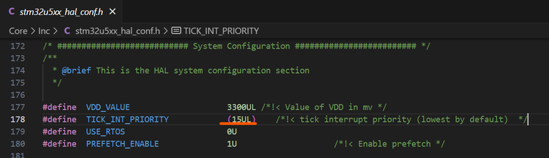

I have set up ThreadX on my STM32U5A9 board using CubeMX. In such configuration it is recommended to use SysTick for ThreadX and select some other timer as a Timebase Source so I selected TIM7.
Now HAL_Delay() and HAL_GetTick() functions are very unreliable. If the system is a bit busy, 1s delay can easily take 10s and HAL_GetTick() counts much slower than it should. The problem is TIM7 IRQ priority. CubeMX generates code setting it to the lowest available priority 15, instead to the highest allowable - probably 1 would be a good choice so it is a bit lower than SysTick priority 0. Where/how do I modify current HAL_GetTick() timer priority in CubeMX?
You do this in stm...hal_conf.h, exactly as on your picture. If the Cube gets in your way when it re-generates the code, fight back and revert undesired changes.

@PawelP All I need is HAL_Delay(), HAL_GetTick() functions working properly.
Needless to say, fighting with CubeMX and reverting TICK_INT_PRIORITY every time code is generated is error/problem prone and it is precisely what I try to avoid, hence it think lack of way to configure and retain this setting in CubeMX is a bug or at least a substantial shortcoming.
