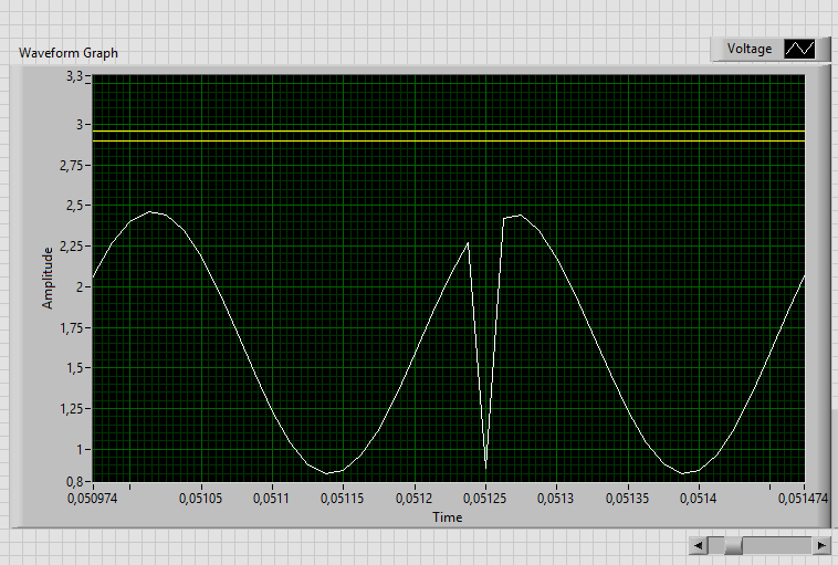

I am building and electric field sensor. The driver signal for it is produced via DAC of the STM32F767zi microcontroller. The signal is 4 kHz and is generated at a sampling speed of 80 kHz via DMA and TIM6. As you can see from the picture the signal has errors in it like every 10-20 wavelengths there is 1 corrupted sample.

seems like interruption from a higher priority interrupt routines causes DMA underruns.
‎2021-03-06 11:31 PM
But would underrun result in an unexpected value to be output? Wouldn't it produce a "stretch" rather than a "glitch"?
I don't think this can be solved without seeing substantial portion of the code.
‎2021-03-07 12:52 AM
The code is simple I load values of a cosine table into the DMA buffer. My first thought was that the DAC hit its limit regarding speed. 80kHz maybe too fast.
‎2021-03-07 1:51 AM
I have done further measurements, the DMA halfbuffer length is 1024. I have 20 samples for one wavelength. 1024/20 results in 51,2 Wave lengths per halfbuffer. When I measure on the oscilloscope the glitch happens exactly at every 51,2 wavelengths. Could it be that the DMA does something strange?

‎2021-03-07 10:52 AM
Is D-cache turned on? Is it managed properly?
‎2021-03-07 10:57 AM
Isn't the first or last value in the calculated array off? Read it out and check.
‎2021-03-07 1:04 PM
The solution for the problem was changing the callback functions to:
void HAL_ADC_ConvHalfCpltCallback(ADC_HandleTypeDef* hadc)
//first half of adc is full
inbufPtr= &adc_val[0];
outbufPtr= &dac_val[0];
processDSP();
void HAL_ADC_ConvCpltCallback(ADC_HandleTypeDef* hadc)
inbufPtr= &adc_val[DATASIZE];
outbufPtr= &dac_val[DATASIZE];
processDSP();
cant really tell why this solved the problem. Occasionally it still happens that 1 sample is pulled high but it can be tolerated.
