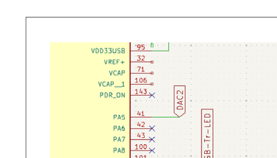

Where are your capacitors for VCAP? Why is PDR_ON floating?

Floating/Missing Pins
So actually they aren't actually floating, I just removed them to better highlight the  situation. I've attached the actual schematic here to avoid confusion.
