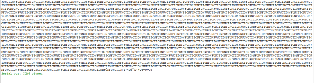

I am working on CAN on STM32F103C8T6.
I am using a Callback Function of (HAL_CAN_RxFifo0MsgPendingCallback) but soon after receiving message code hangs in Callback Function even though no data sent afterwards it.
I am not getting the reason. Because this function works fine on CORTEX-M4 pocessor.
However, Transmit_Interrupt is working fine. But receive interrupt is hanging.
Here, is the code Snippet.
Code is getting stuck in the receiver callback function (HAL_CAN_RxFifo0MsgPendingCallback).

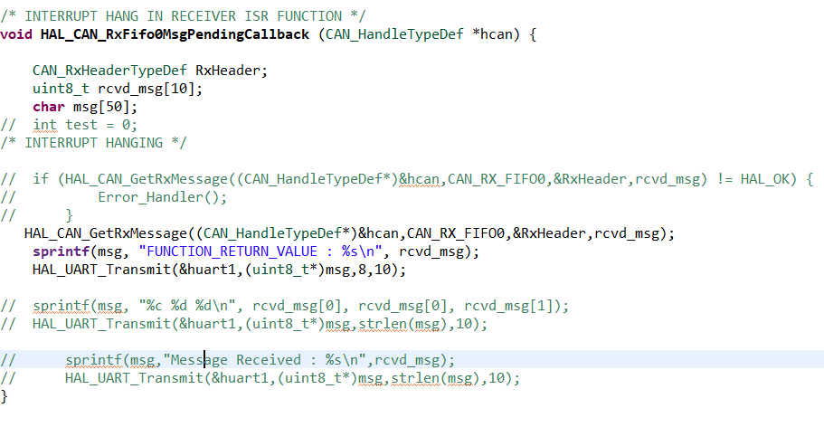

/* INTERRUPT HANG IN RECEIVER ISR FUNCTION */
void HAL_CAN_RxFifo0MsgPendingCallback (CAN_HandleTypeDef *hcan) {
CAN_RxHeaderTypeDef RxHeader;
uint8_t rcvd_msg[5];
char msg[50];
if(HAL_CAN_GetRxMessage((CAN_HandleTypeDef*)&hcan,CAN_RX_FIFO0,&RxHeader,rcvd_msg) != HAL_OK)
Error_Handler();
sprintf(msg,"Message Received : %s\n",rcvd_msg);
HAL_UART_Transmit(&huart1,(uint8_t*)msg,strlen(msg),10);

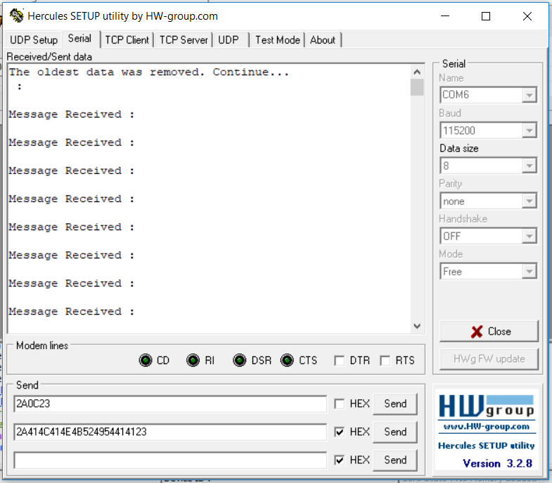

I propose to increase table rcvd_msg from 5 to 8 elements.
Perhaps 9, and insure the data is properly NUL terminated to use string functions against it, and content is ASCII​

Yeah, I tried but it is still hanging in Receive Callback Function.

Callbacks done under interrupt context, would avoid calling things which can block, or have delays/timeouts dependent on other interrupts. Would avoid printing to uart.
Queue or buffer data to be handled off critical path.
Don't see you dealing with NUL termination. Post code in formatted code block, not screen grabs.​
