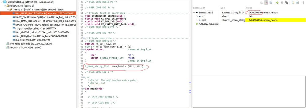

I am absolute noob with stm32 and i am currently trying to connect GY-GPS6MV2 module to RobotDyn STM32 Mini(STM32F103C8T6).  I have connected GPS module to pins and set up USART1 in asyncronous mode. I have done everethyng according to official example on how to work with USART1 using DMA. In the interrupt handler i wrote small piece of code to copy data from rx buffer to linked list. But from here things have gone really weird, because in the debugger i see, that my global variable(nmea_head, this is first node in linked list) is allocated in the same memory area where irq handler stack resides(See attached screenshots). What am i doing wrong?

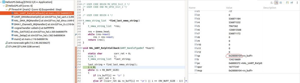

Here you can see, that SP for HAL_UART_RxCpltCallback is at 0x20000104
This is definition of global variable nmea_head. On the right side you can see, that it was placed on the address 0x20000110. This address overlaps with stack frame of HAL_UART_RxCpltCallback, so my variable gets corrupted. What am i doing wrong?
This  happens prior to any calls to malloc or free, and i am not accessing this variable from anywhere else, so there should not be any race conditions.
Best answer by KnarfB
Looks like the MCU is booting from system memory. The next address (initial PC) is in the System Memory Area (0x1FFFF000-...) with the internal boot loader. Maybe such a little stack space is okay for that boot loader.
The board should have a BOOT0 pin/jumper that must be set to low for booting your code from user flash area (0x08000000-...)

Do you have larger local variables occupying the stack? If you click through the call stack (left), you can check this and by looking at the value of sp in various depths of the call/exception hierarchy. Expected behaviour:  the initial (downmost) sp is close to the top of the SRAM and decreases only mildly from stage to stage.

I ckecked memory during after reset:
This is why i have invalid SP/MSP. But where does this value come from?
Whats written in the project linker script file (.ld)?
BigBrickAuthor
August 2, 2024
Thank you, setting BOOT0 jumper to low fixed it.
