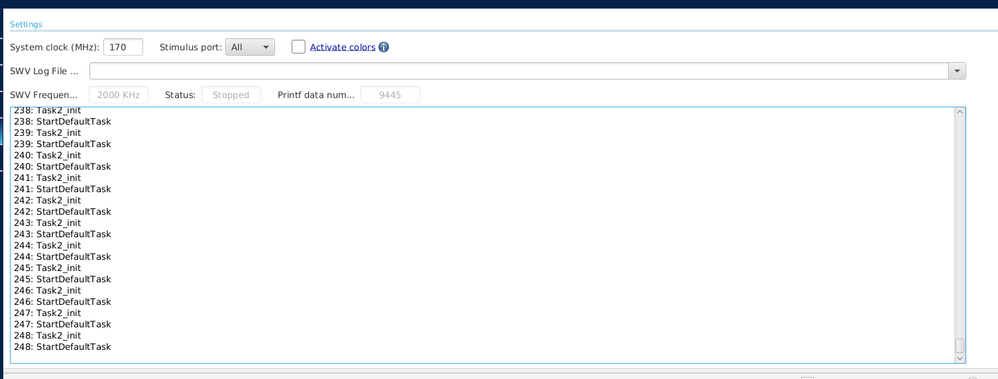

swv itm data console stop printing after few lines
‎2024-01-07 2:18 AM
Hi There,
I am using a SWV ITM to print the messages but it always stoped printing after 221 counter number as below image. Could any tell us what needs to be set to see continues printing.

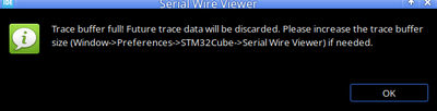

‎2024-01-11 6:58 AM - edited ‎2024-01-11 6:59 AM
I tested just prinf ... in IDE (1.13.1) :
26242 lines text ..then error.
this might be the problem:
(But my buffer is already at 2000000; try to increase yours.)
‎2024-01-11 7:41 AM
Hi AScha,
I am using FreeRTOS and I am using UBUNTU and STM cube ID is 1.14.0.
Im my case i have not seen above messages as my trace buffer size is 2000000.

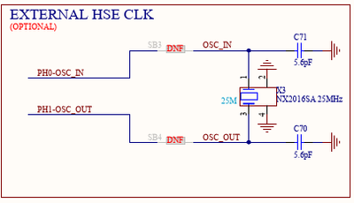

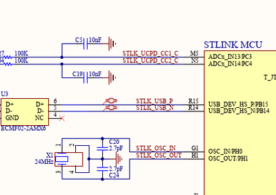

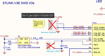

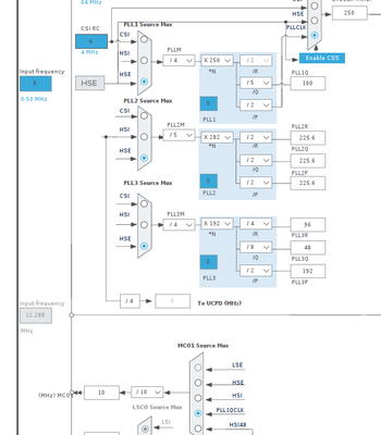

‎2024-01-11 8:05 AM - edited ‎2024-01-11 8:11 AM
Hi @Tesla DeLorean ,
btw
HSE_VALUE on (new) H563-nucleo is 8M , from ST-LINK/V3 onboard,
i tested mco , makes 10,000xx Mhz on DSO counter.
"NEW" : stlink has 24M clk on H563-nucleo 144 here ... :)
NOT the (older) 25M oszillator , giving 25/3 = 8,3333 M ; (silly idea) on H7B3-disco here:
ps : But somewhere in the big company the guy with the "25MHz" reference idea still working,
because there is a crystal onbord the new H563-nucleo 144 , and guess which frequ.:
