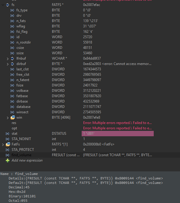

I stepped into find_volume() and it fails the check on line 14 of the last code excerpt I attached in my last reply.
This is what I get after the find_volume() function.

This is where it gets to line 30 in the above code, returning FR_NOT_READY.
stat = disk_initialize(fs->drv) returns error. "Failed to initialize due to no medium or hard error"
Happy debugging...
After diving a bit more into find_volume() from f_mount, assuming that vol = 0 is a valid value, I see that the condition in line 2 (code below) is not fulfilled, because fs_type returns 0 instead of FS_EXFAT, which should be the case according to the FATFS documentation which I attached here . It also seems like fulfilling that condition (fs_type!=0) is the desired case.
