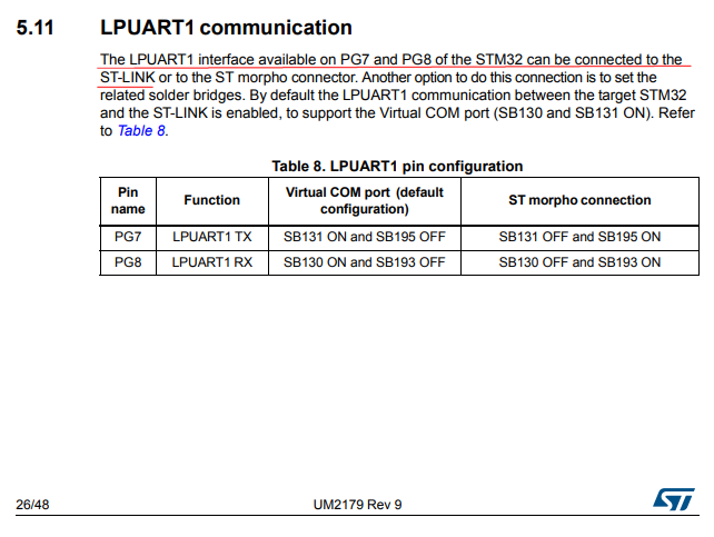

@RiccardoMilici wrote:3. In Pinout & Configuration I go to Connectivity -> USART2 -> Mode Asynchronous and leave the default values.
User manual says it's LPUART1 connected to the VCP:

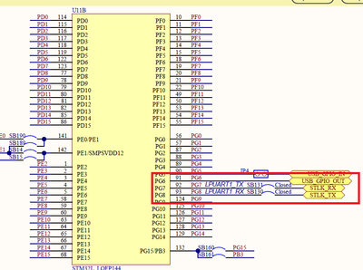

‎2024-11-20 3:53 AM - edited ‎2024-11-20 3:54 AM
Simply because USART2 is not connected to STLINK virtual comport on NUCLEO-L496ZG-P board.
Based on the board schematics, you need to use LPUART1 instead:
