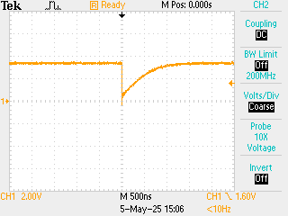

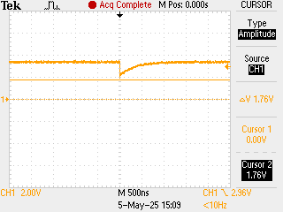

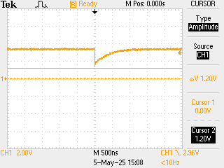

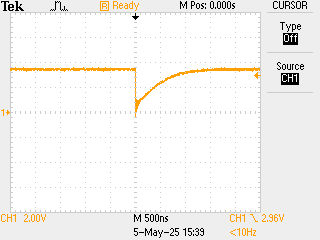

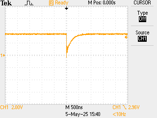

Yes, nWE is at PD5, configured as Push-Pull, no pull-up/pull-down, very high speed.
Very high speed = very high strength, potential of noise and ringing.
So try with a hardware pullup (10k ?) on PD5 , speed at low.
We don't have problem with noise or ringing. But I measured it.
Since we also have 20ns RAM on the bus, we need High or Very high speed.
Very high
High
Medium
Yes, of course.
Without 10k pull-up
With 10k pull-up
Glitch to 0V is very strong.

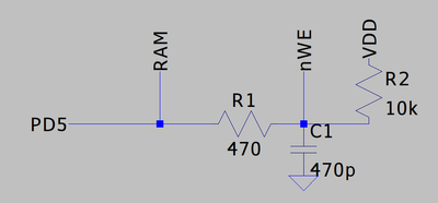

so if you dont need hi speed on the nWE , but on PD5 want hi speed,
you could put a resistor + cap in the line to nWE , preventing fast spike just for this ,
and let PD5 on hi speed setting.
