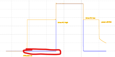

I’ve attached two scope captures showing two different behaviors. In both:
  • Blue = VEN (EN pin voltage)
  • Orange = VOUT (LDO output)
In Figure 1 STM32 is not in use and I manually drive the enable pin to the GND and to VCC interchangeably. As expected, VOUT drops to 0 V when VEN goes low.
In Figure 2, The STM32 is powered on, and PC1 is initially configured low. VEN is low, but VOUT rises to 1.8 V, even though it should be off. When STM32 drives PC1 high, VOUT rises to 2.8 V as expected. When STM32 drives PC1 low again, VOUT only drops to 1.8 V, not 0 V. When the STM32 is powered off, VOUT gradually drops to 0 V.

Blue is EN/PC1? And yellow is VOUT from the LDO?
You say PC1 isn't being driving to 0V but it looks 0 V to me. Am I missing something?
If PC1/EN is low, it doesn't matter what is driving it or how. It's low.
If you get different behavior on the output with EN low with STM32 attached vs not, it's not due to how EN is being driven.
Show the full schematic. You're missing something else in there.

After removing the LDO, as per your recommendation, I measured again the output voltage where i previously measured it and it still read 1.8V (I've attached a picture).
It is worth noting that this output of the LDO is passed as input to a radio chip, which has many inputs and outputs connected to the STM32.
I am now thinking of driving all of these shared signals low, and measuring again the voltage where the LDO output  was previously.
