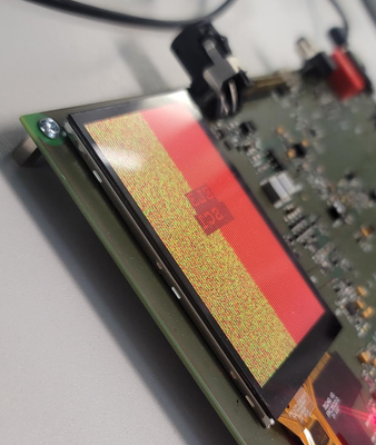

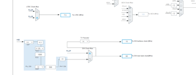

Hello ST Community,
I'm facing a MIPI DSI configuration issue with my STM32U5A9 and TFT LCD. When using PHY DSI as the DSI lane byte clock source, my code fails with a timeout on HAL_DSI_ShortWrite. When I switch to PLL3P, the initialization proceeds, but the LCD displays distorted images.
Request for Assistance: I'm new to MIPI and suspect a misconfiguration in clock settings. Any insights on proper configurations or similar experiences with STM32U5A9 MIPI DSI would be greatly appreciated.
Details:
- MCU: STM32U5A9
- LCD: TFT LCD with st7796S
- Clock Source: PHY DSI (fails) / PLL3P (distorted images)

‎2023-12-01 9:21 AM
Characters have been successfully displayed on the LCD; however, they appear inverted and mirrored. Assistance in identifying the underlying issue would be greatly appreciated.
Your guidance in this matter would be highly appreciated.

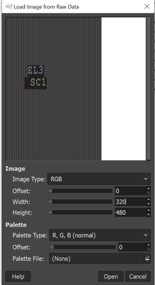

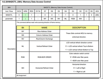

‎2023-12-05 1:14 AM - edited ‎2023-12-05 1:16 AM
Dumping the framebuffer and displaying it on GIMP confirms that the transmitted framebuffer is accurate, but there seems to be a misinterpretation by the Display controller.
I've attempted various configurations on the controller's side to address the issue, but the text continues to display as mirrored.
Alternating the MX bit in the this register, had not impact on the outcome - Any ideas would be much appreciated!
