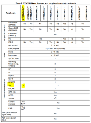

I have not seen table 2 (telling me just one SAI) - OK, got it.
But the pin/ball definitions give me the conclusion, that available pins would even support SAI2.

Thank you for this feedback. The STM32U5A5RJT6Q (LQFP64) have one SAI as mentioned in the datasheet table 2 based on that it didn’t have an SAI2.
The "STM32U5Axxx pin/ball definitions (1)" table  covers all IP available on that pin regardless of package. The customer should be referred to availability of IP on his product package. This behavior is explained by this note:
"1. Function availability depends on the chosen device."

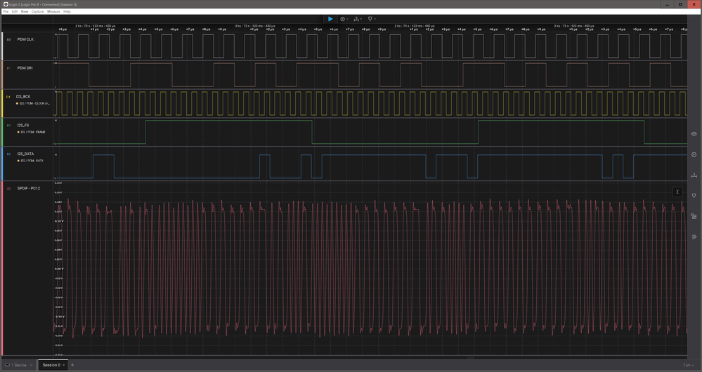

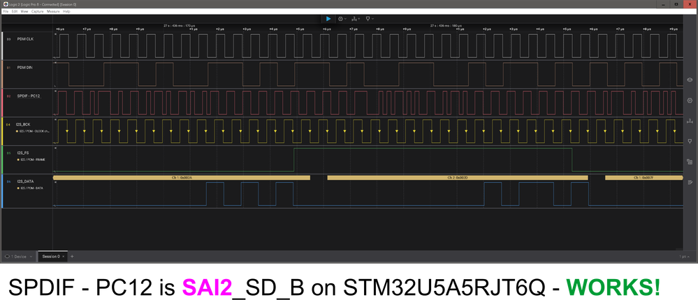

I can REALLY confirm now: even the STM32U5A5RJT6Q package (LQPF64), even mentioned in STM datasheet - it has also a SAI2 (not just one SAI).
I can configure, I can use, I can forward via PC12 as SAI2_SD_B and generate an electrical S/PDIF output: it works, I get the PDM audio on the external S/PDIF receiver.
Here a video about the setup and the proof that it works:
https://youtu.be/693O82ngsMs
Here the waveform for all audio signals in system:
The PC12 output here is "analog" (with external S/PDIF circuit) - it works!
Please, give me Kudos for having found a feature not (or wrong) documented in STM32U5A5 datasheet... - LOL

Even if SAI2_SD_B and SAI2_SD_A work, but they are not guaranteed to be functional since they aren’t tested in production.

I saw it working once (but with a lot of audio artefacts). Now, I cannot replicate anymore: even I see the SPDIF signal coming out - I cannot receive it. I might need a SPDIF decoder on scope (or another STM board with SPDIF RX, just to figure out what is wrong, via checking Rx status and data). I assume, the clock config is not yet correct or the handling of the CS, U, V bits.
When you say "not tested": I understand that datasheet says for STM32U5A5 LQFP64 package just one SAI1, not SAI2 (even some pins for SAI2 are there). But the LQFP100 has support for both SAIs. Why SAI2 should not be tested? If it works for LQFP100 package - then it should work also on LQFP64 package, shouldn't it?
Maybe, I try SAI2_A as I2S, the pins are there (PB13, PB15, PC0). For SAI2_B, the SAI2_FS_B is missing on LQFP64.
