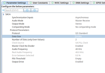

Hi AScha.3,
​Thanks again for your guidance. I followed your suggestions about enabling callbacks and disabling ICACHE, which allowed the debugger to work. I also reviewed the SAI settings.
​I tried configuring SAI B based on your example parameters, ensuring Output Drive is Enabled. Here is a screenshot of my current settings:
​Key settings in this configuration:
​Protocol: I2S Standard
​Data Size: 24 Bits
​Master Clock No Divider: Enabled
​Audio Frequency (Target): 48 KHz (Note: Changed from 16 KHz in earlier tests)
​Fifo Threshold: Empty (Still set to Empty based on your screenshot example, maybe this is wrong for Receiver?)
​Output Drive: Enabled
​Results with this configuration:
​The DMA callbacks (HAL_SAI_RxHalfCpltCallback and HAL_SAI_RxCpltCallback) are still not being triggered. My counters inside remain zero.
​Oscilloscope: I probed the SAI pins:
​SCK (PE12): Shows a clock signal (frequency corresponds to 48 KHz target and settings).
​WS (PE13): Shows a frame select signal (48 KHz).
​SD (PE11): Shows data activity from the microphone.
​Remaining Issue:
Even though the clocks are generated and the microphone is sending data, the DMA interrupts are not firing.
​Could the Fifo Threshold setting being Empty be incorrect for Master Receive mode? Should it be Half Full instead?
​Also, in the CubeMX Clock Configuration tab, although I target 48 KHz, the Real Audio Frequency shows 0.
​Any further advice, especially regarding the Fifo Threshold setting for receiver mode, would be greatly appreciated.
​Thank you!

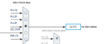

So on H7S3 , SAI shows:
with clock setting for SAI:
+ try setting stereo...as i dont know, what "mono" doing with 2 channels (I2S is basically always 2 ch, L+R ).
+ try fifo..half, if you like; it will not explode...just 30 sec and you know.
+ btw  look at ..N657X0 errata sheet, just to exclude, there is a known problem.

>verified the `SAI Kernel Clock` is ~2MHz
Whats the `SAI Kernel Clock` ? the 24M i have for SAI ?
because
shows: the SAI clock much to low, try as i do, to set it to 24.xx M .
-> Real Audio Frequency should show, what you get.
Now you get .... 0.

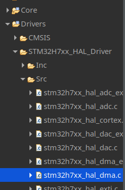

so expected Fs now shows something close to 48k ?
I just looked at your program...as i dont have a N657 , i am on H743 (here, for my audio player);
you use HPDMA , i just normal DMA , but what i miss , is the DMA setup, before using it. (But maybe not needed on N657, look for an example or just try. Look in the driver, whats there as comment/info.)
And callbacks registered .
And your buffer so small - why ? (I have 4K buffers)
so first init dma, then start SAI :
//main...init
  HAL_SAI_RegisterCallback(&hsai_BlockA1, HAL_SAI_TX_HALFCOMPLETE_CB_ID, HAL_SAI_1a_TxHalfCpltCallback);
  HAL_SAI_RegisterCallback(&hsai_BlockA1, HAL_SAI_TX_COMPLETE_CB_ID, HAL_SAI_1a_TxCpltCallback);
 fresult = HAL_DMA_Init(&hdma_sai1_a);
 	fresult = HAL_SAI_Transmit_DMA(&hsai_BlockA1,  (uint8_t *)playbuf , (sizeof(playbuf))/4);	// master start
 (just from my prog, you have to use your names and SAI_receive of course.
