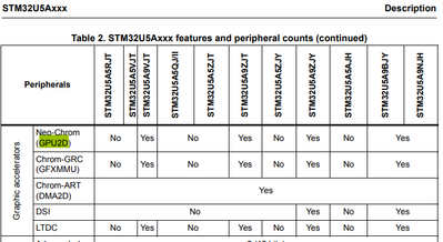

Correcting your response:
- my STM32U5A5 does not have GPU2D (the reference manual is confusing: it tells me there are GPU2D registers, but not which and later it says: GPU2D is just available on other parts (e.g. STM32U599))
- Even I would have a MCU with GPU2D - the MCU cannot make use of DCACHE2:
This is a Read-DCache for the GPU2D core, on M0 port! MCU cannot write and read from it.
DCACHE2 is for GPU2D only access-able (to speed up reads from slow external memories, e.g. containing textures)
Anyway, great to know it works to use DCACHE (16KB on U5A5) as "regular memory".

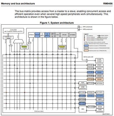

First let me thank you for all the insights and proposals. Maybe it would be more convincing if we have only DCache1. However,
STM32U5xx product embeds 2 DCACHE 16KBytes each: DCACHE 1 dedicated to external memories and DCACHE 2 placed on GPU2D M0 port and dedicated to improving performance of data traffic to/from external and internal memories. From application perspective, these features allow better performance close to zero wait state data access and lower power consumption when addressing small internal DCache.

Indeed, U5A5x does not have GPU2D. Sorry for the confusion, U5A9x does have GPU2D.

Thank you @tjaekel for teaching me this valuable lesson :beaming_face_with_smiling_eyes:
Indeed, DCACHE2 is only addressable by GPU2D
