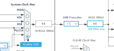

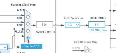

I'm trying to crank up the clock to Timer1 to be able to count high frequency events with better resolution.  If I set the SYSCLK to 128 I get a hard fault when my code reaches SystemClock_Config().  Even if I keep the AHB bus at the same speed (64Mhz) using prescaler.  In this case the only clock difference seems to be SYSCLK value.
Here's the first configuration which works ok:
and here's the other where it will hard fault:
Since the IDE says I should be able to take HCLK to 160Mhz which would require a much higher SYSCLK, I don't see why this SYSCLK value should cause a fault.

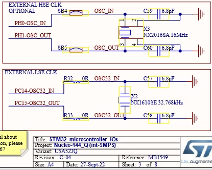

Best answer by AScha.3

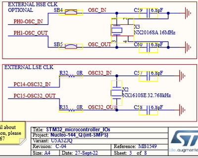

Board should have 16M crystal:
So your sysclock "136M" setting is 272 MHz , a bit too much for 160MHz cpu. :)
Set your clocktree with 16M HSE, and sysclk 160M , AHB div. 1 , so AHB also 160M.

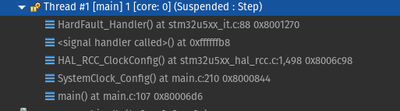

Here's a backtrace:
a HAL_GetTick() is called after modifying RCC->CFGR1

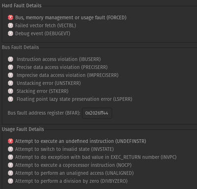

And here's some fault analyzer output:

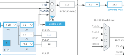

I've had some luck stepping up the PLL frequency in steps.
So far, I've been able to get the SYSCLK up to 112Mhz.  Will keep experimenting.
moylandoAuthor
May 12, 2025
Yes, 112Mhz seems to be the max, but it's working with HCLK = 112Mhz also, when it doesn't work with SYSCLK = 128Mhz and HCLK = 64Mhz via the divider.  I don't have SYSCLK being used by any peripherals so unsure why there would be any sensitivity to it.

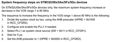

This section from page 411 of the ref manual has me curious:
The wording here is a bit unclear.  When it says 'system frequency' are we talking about SYSCLK or AHB?  Seeing as they recommend using the AHB prescaler I would think that's what they're referring to.  However, in my case, fixing it to /2 which brings the AHB within this range (SYSCLK=128, AHB=64) doesn't seem to make a difference.  Could this limitation apply to SYSCLK?  I've verified the VOS range is 1 (CubeIDE sets this depending on the initial SYSCLK configuration)

May 12, 2025
No, doesn't work.  Any setting with SYSCLK > 112Mhz does not work.  I've tried 160Mhz with multiple AHB prescalers (not even upping the AHB frequency later, so AHB stays lower) and it seems totally insensitive.  The only factor I've been able to deduce is the SYSCLK setting.
